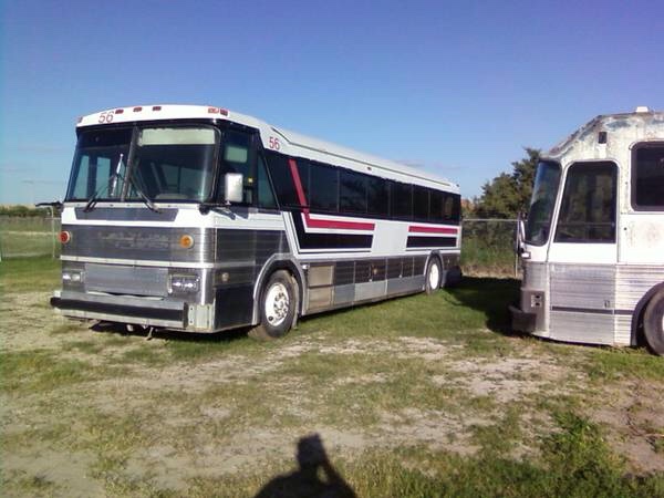

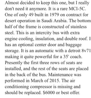

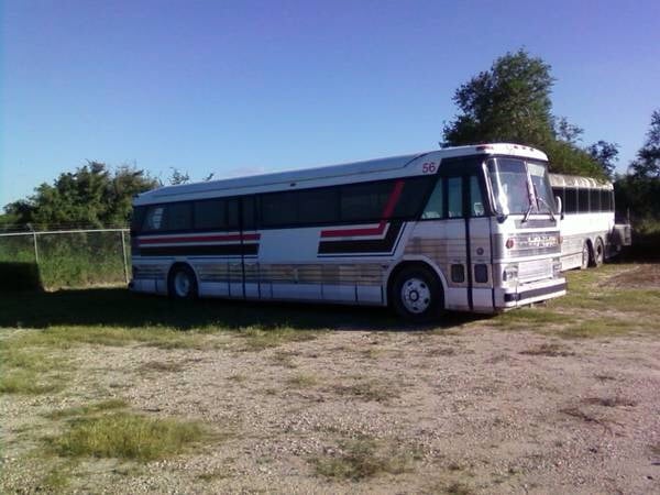

We are near McAllen for 6 weeks so I poked around craigslist for fun. Found a double roof Saudi bus and it really would make the perfect conversion for someone. 35' single rear axle, double roof and factory mid entry door. Also, what exactly is the "extra cooling"?  Here's the ad:

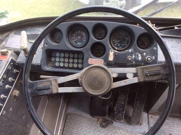

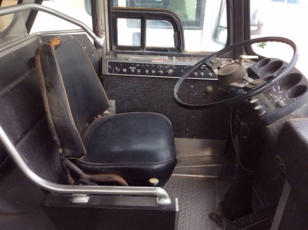

Looking at the pictures again, I see the Allison shift knob beside the driver's seat, and no clutch pedal. So I think it has the 6V71. It will get you down the road, but not very fast.

Stock fitment on the Saudi buses was a 6V-71N  with Allison 740.  You can put an 8V-71 and 640 combo in there and in busnut use has proven to be very reliable.  The roof is a second skin fastened about an inch off the standard roof with an air gap, supposed to be quite effective.  I may be biased but I think this would be a great conversion starting point.  I really favor the side door, the roof, the compact size makes it quite easy to park.  The 6V92TA swap is easy since you can use the same engine mounts as on the 6V-71 (you just need to remove the water pump to get the subframe on, and to swap out the front gear cover to the MCI one that has the engine mount boss).  I don't know about the extra engine cooling but it may have it, they were customized for the extremely hot Saudi weather.  Might have MC-9 radiators, they were built at the same time as these buses.

There is no extra cooling that I have found and it does have the double roof which does help with the heat. The mid d9or was for the women to enter the bus because over there they were not allowed in the front. Not a bad little coach but be prepared for interesting fixes. No lifts on rear door where the mid door was and matching the siding is expensive unless you can find that door. I haven't.

The "extra-cooling" usually means the double "Saudi" roof and an additional A/C evaporator unit in the rear of the coach.
