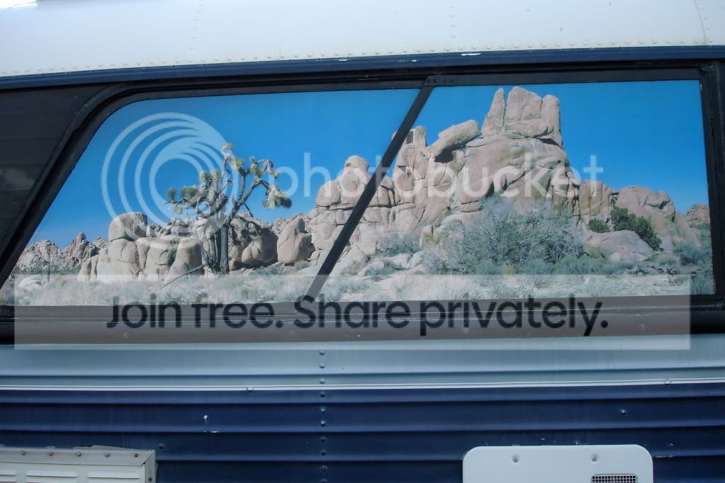

I will try to post a pic but my question is how will a window get broke or become broken? It's protected on both sides and pretty much packed in place not to mention the original installation!
