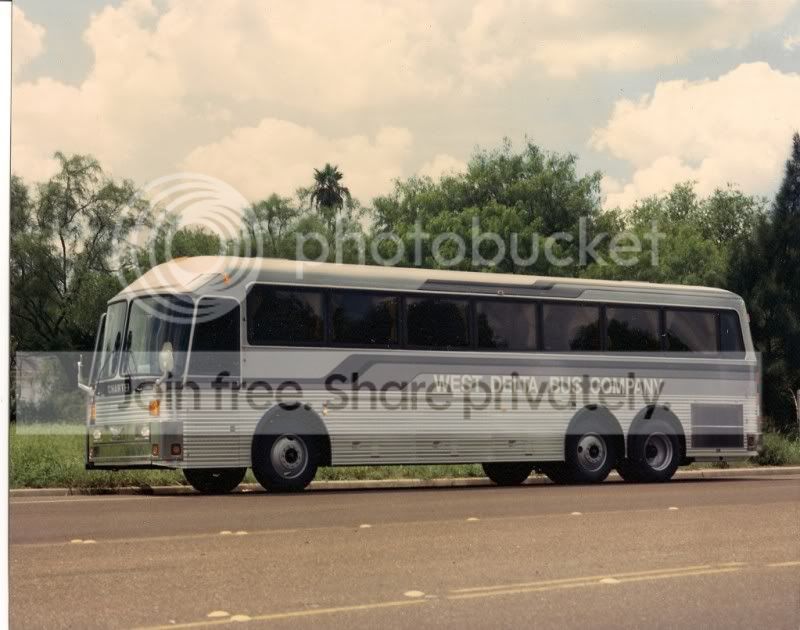

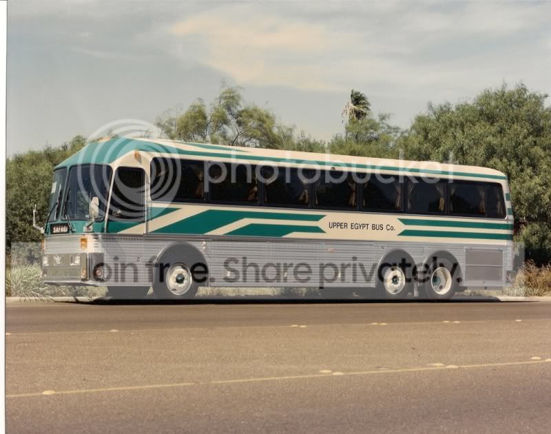

There were some busses built for use in Saudi (I think) that had a double roof for just that reason. I saw a picture of one once. I think it was a Eagle.
Heres a couple of the Eagles that went over there, courtesy of smoothjazz, thanks Dan.

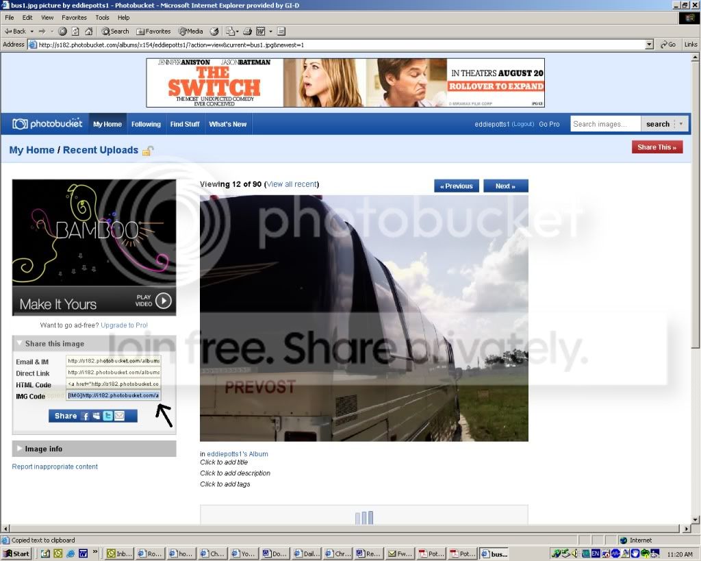

Joe I want to see them. I use photobucket to post pick. After I upload my photo to it I just copy the image code and paste it in.
