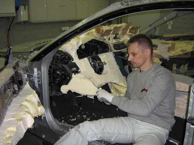

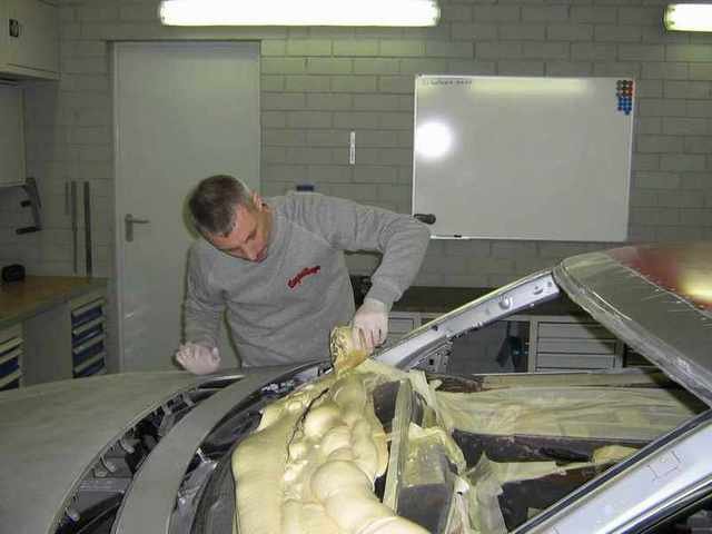

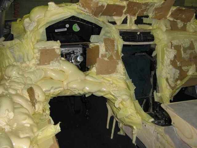

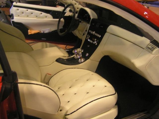

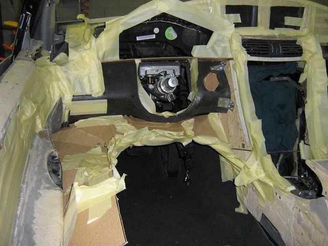

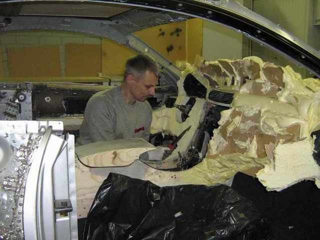

Standard polyurethane insulation foam sheets, sold by DIY shops. (Not polystyrene - that melts when touched by fibreglass resin). Note that the foam doesn't necessarily form part of the finished structure - it can all be removed if required once the fibreglassing is done, although leaving a layer of foam behind the glass where you have space to do so will add greatly to the stiffness of the fibreglass.
I just Googled to find a website that showed the technique (ie. carving foam and then fibreglassing), and amazingly came across a site where someone has actually made a dashboard this way. Note that this guy has used liquid-mix foam rather than foam sheet, which is another approach (but looks pretty scary in the early stages). You could equally well use the large aerosols of expanding foam also sold by DIY shops.
For the complete site from which the photos below come see http://englishrussia.com/index.php/2008/05/29/lithuanians-and-pu-foam/
Note that I'm not necessarily recommending you try this - it's a lot of messy work, and if you weren't confident about what you were doing might well leave you in a bigger hole than you are already. But it's interesting to know what's possible - you might for instance make the main structure of the dash out of wood as originally planned, but use foam in a small area where you needed a strange shape.
