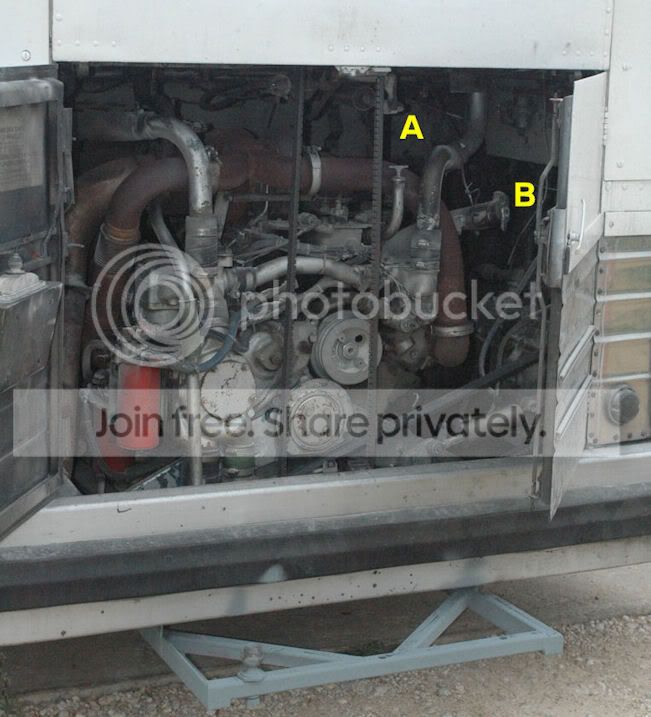

I have space in the rear corner of the engine compartment to put three g31's.
Three d31 or three g34? Going in o5 Eagle 8v71.

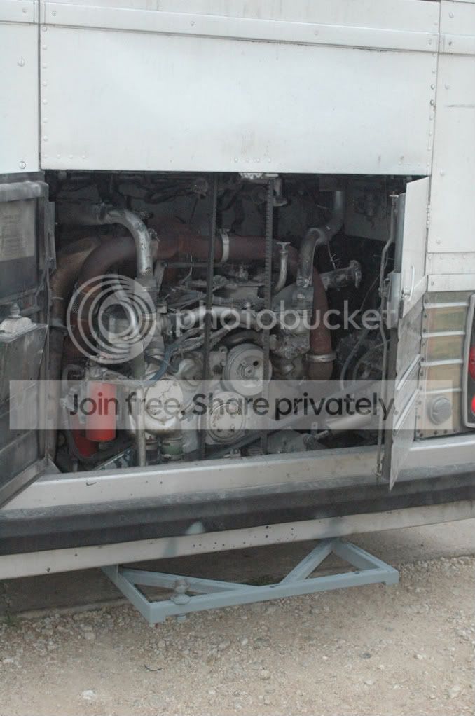

The truck parts place had a pallet of interstate blem 31's for $ 50.00 ea. I bought three. The 8d's are about three years old and even tough a little big for the battery boxes in the mack dump will work there. The cost was less than half that of the ones with the pretty plastic wrap on them. Same exact battery just a ding or scratch. I am going to build a battery box right inside the bumper. Frees up the entire compartment where the ac con. was. Lots of ideas!!!! BBQ GRILL, MANLY SIZE TOOL BOX, BIG COMPRESSOR, PRESSURE WASHER FOR THOSE LONG TRIPS WITH THE 8-71....etc.
Eric, Are you planning on around the mitre box  area? I have seen that done on an 01 and it looks like a great spot. He built a frame out of angle and dropped them in, he had one square frame on top to secure them.
Pictures please when you build it, OK?
Ericbsc
Thats correct. On the passenger side.

Eric, I saw those pictures at the Eagle site of your engine compartment.......you should post them here......its impressive!  Nice looking!
